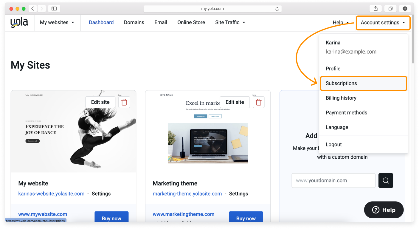

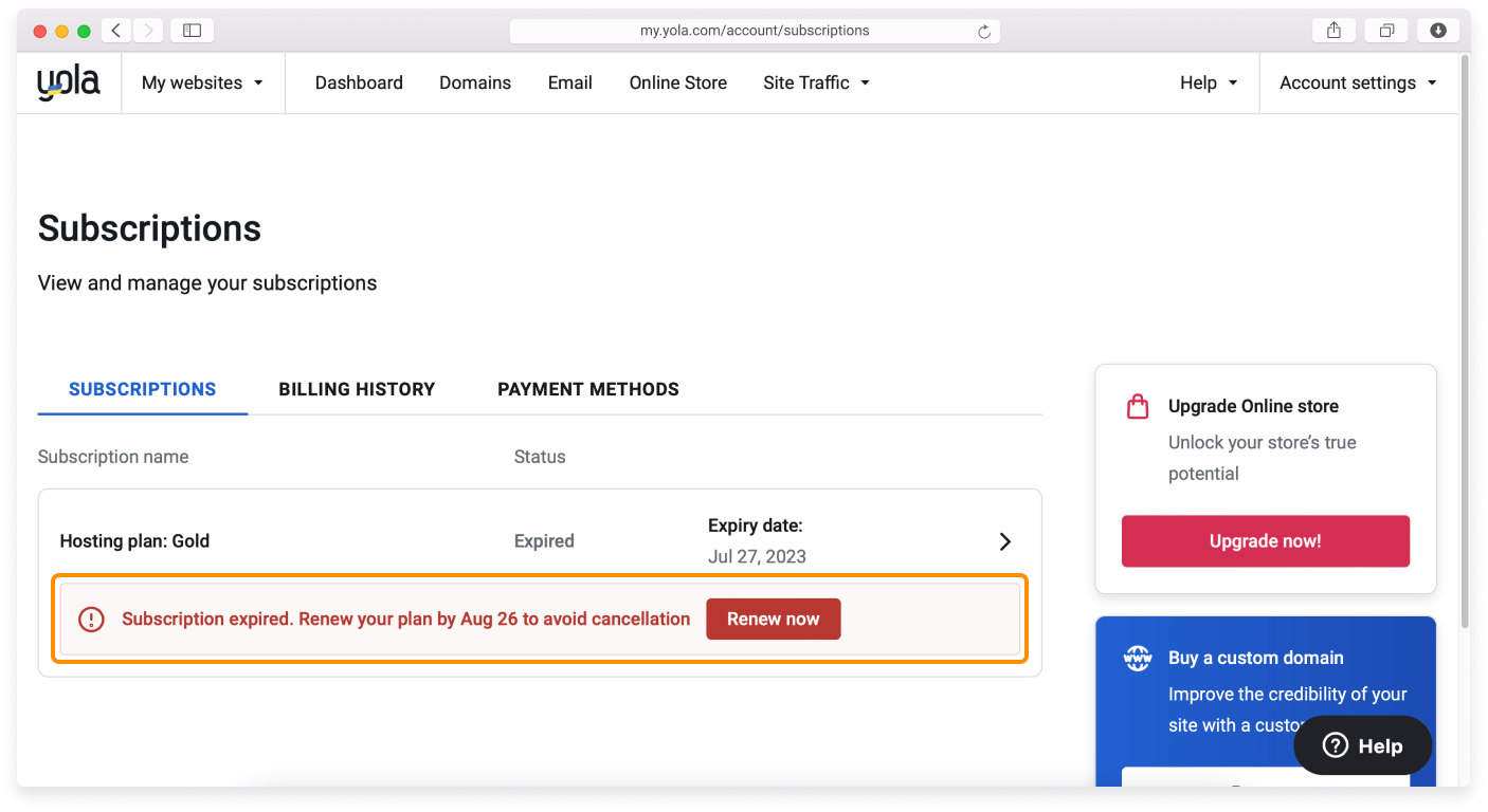

To check your hosting subscription status, follow these steps:
  1. When in the Dashboard, hover over the Account settings link on the Topbar and choose the Subscriptions option from the dropdown menu.
  1. In the Subscriptions tab, take a look at the Status column next to your hosting subscription.
In case the status is Expired: click the Renew now button and proceed to the checkout to reactivate your subscription for another term. Once your subscription is active again, your website will be back online within a few minutes.

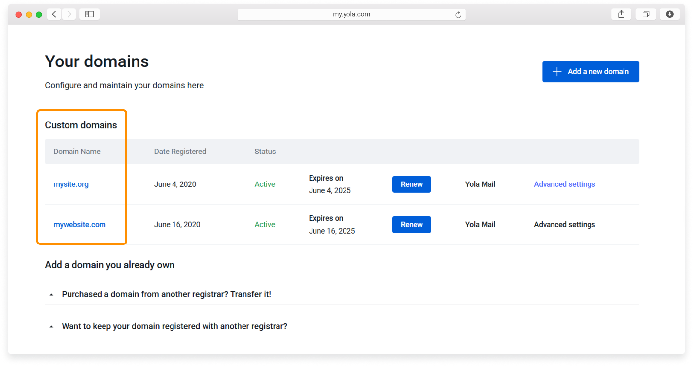

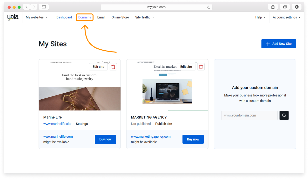

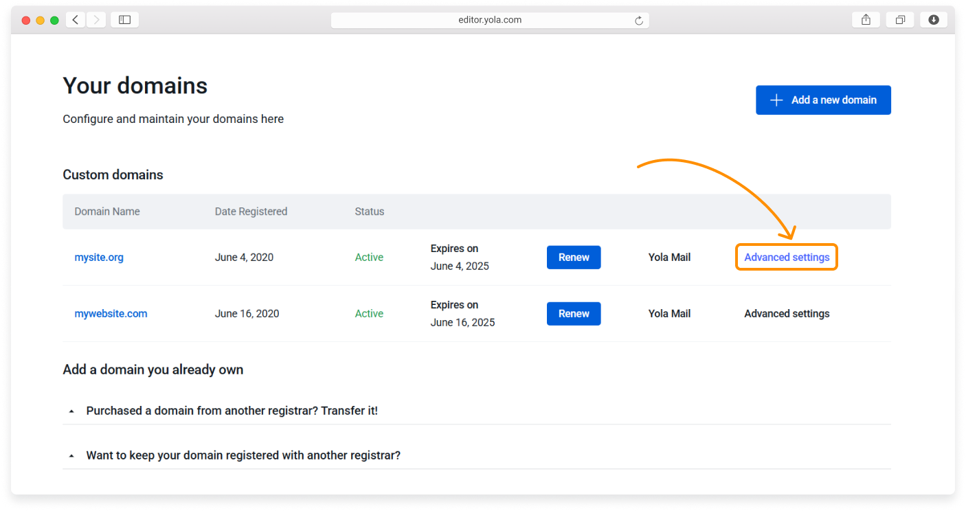

  1. Go to My Yola dashboard and click Domains on the Topbar.
  1. Under Custom domains, find the domain name you used to publish your website.
  1. Take a look at the Status column:
In case the status is Expired: click the Try to renew button and proceed to the checkout to reactivate your subscription for another term. Once your subscription is renewed, default DNS records will be re-added to your domain and will need to propagate. Please wait up to 48 hours for your website to be back online.
In case the status is Active and your website is still down after you’ve renewed your domain and waited 48 hours, proceed with the troubleshooting instructions below.

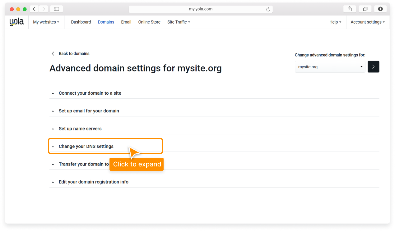

  1. Go to My Yola and click Domains on the Topbar.
  1. Under Custom domains, find the domain name you used to publish your website and click Advanced settings next to it.

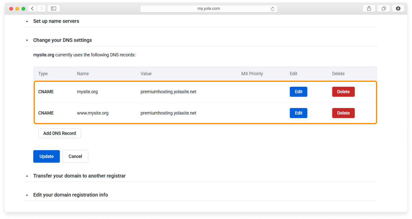

  1. Scroll down to Change your DNS settings and expand the tab.
  1. Take a look at your domain’s DNS records:

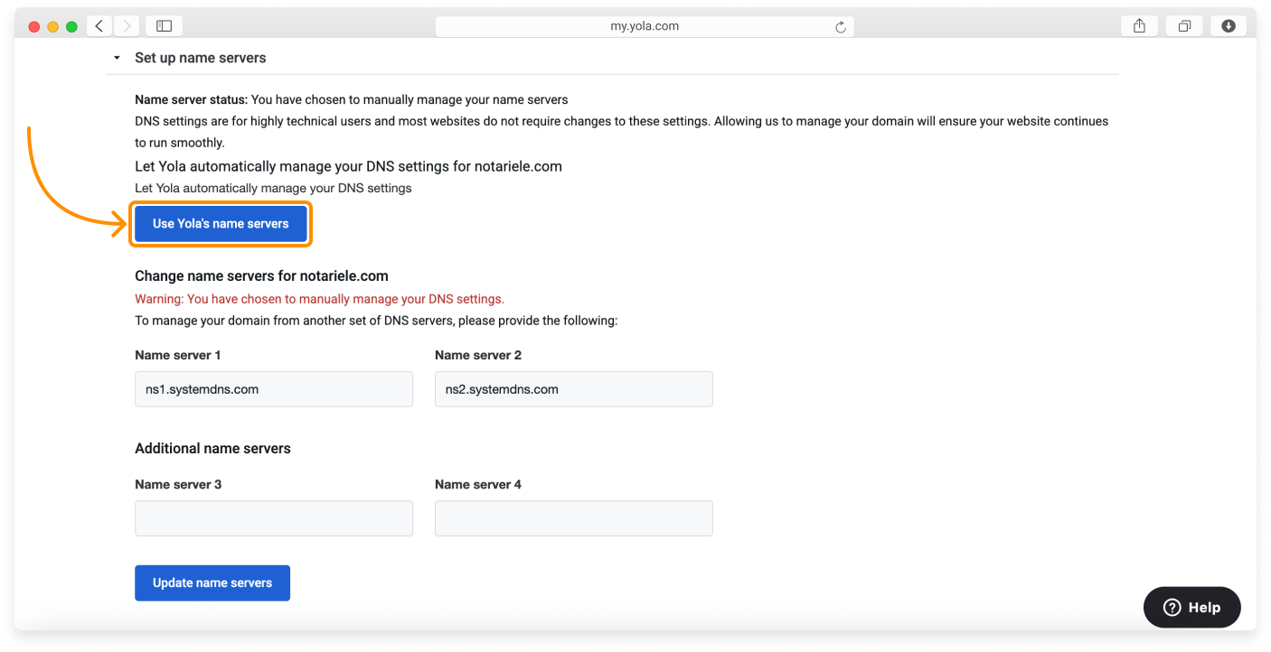

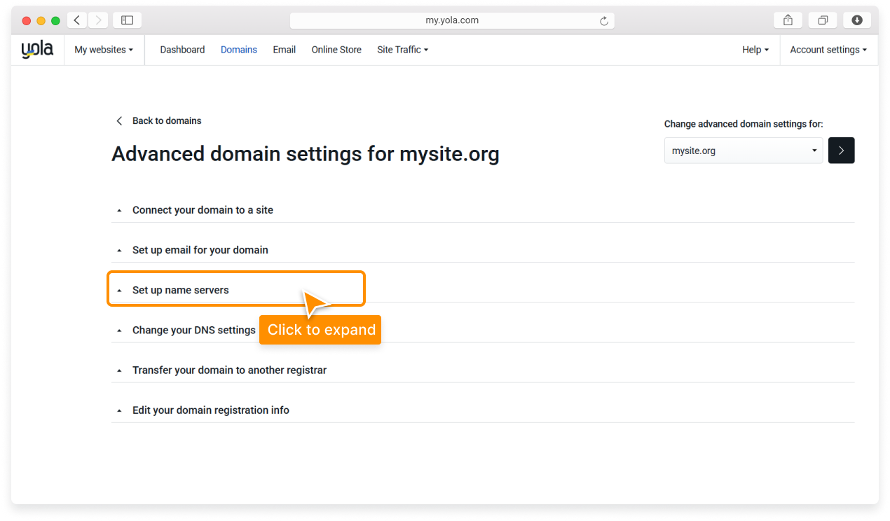

  • If you are faced with the “Name servers for yourdomain.tld are not hosted with Yola. Please manage your DNS settings with your name server host.” warning in red, scroll up and expand the Set up name servers tab.
There, click the Use Yola's name servers button.
Once you see a success message that your name server records are updated back to Yola, refresh the page to verify that other required records have been re-added as well under the Change your DNS settings tab. Here is an example of how these records would look on your domain:
  • If you are using Yola name servers, please also make sure that you have two CNAME records on file for your domain. If the above records are missing, please add them manually:
Type  Name Value
CNAME yourdomain.tld premiumhosting.yolasite.net
CNAME www.yourdomain.tld premiumhosting.yolasite.net
Note:  When adding the reсords, replace yourdomain.tld and www.yourdomain.tld with your actual domain names, for instance, mydomain.com and www.mydomain.com.
